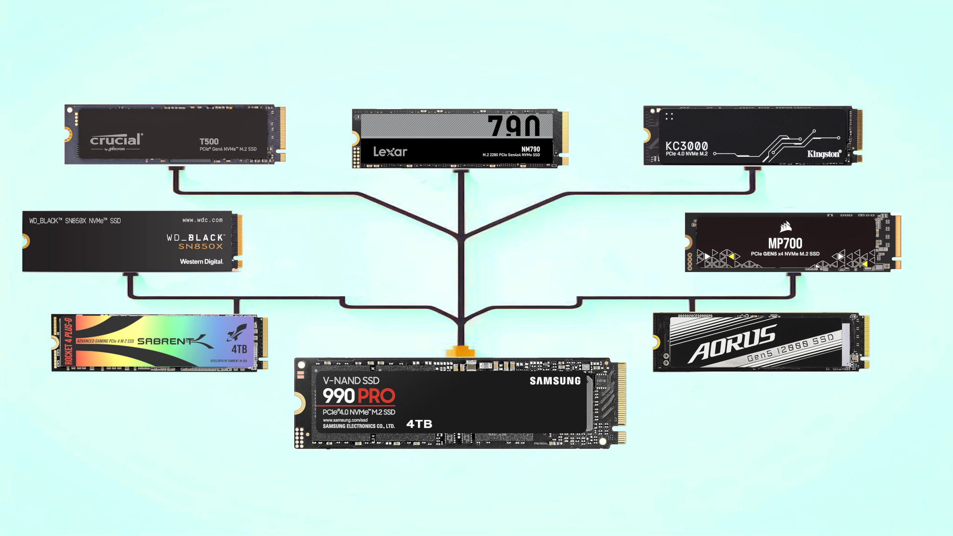

Some discussion topics:
What is your experience with certain brands and models?
Preferred architecture?
What filesystem/RAID setup?
Advantages remaining to HDDs besides sheer size?
Share tips about prolonging life, maximizing performance, etc.
